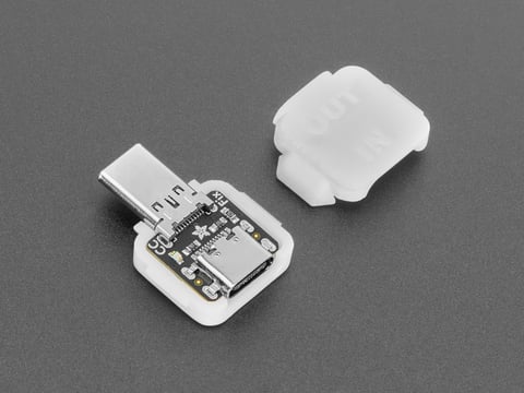

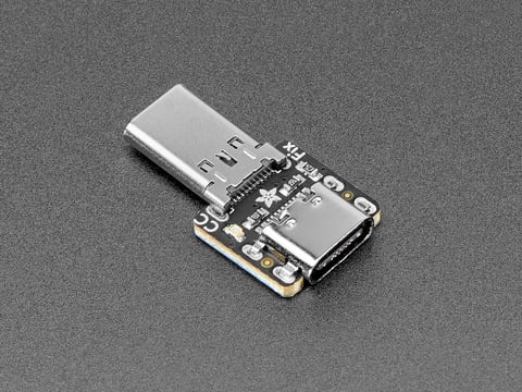

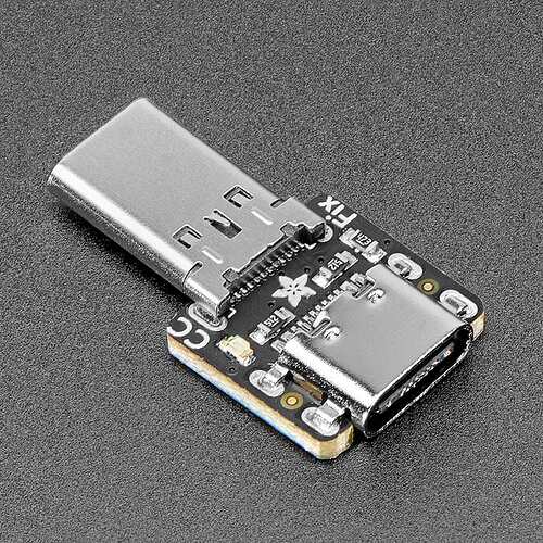

I am currently trialling this solution from ADA Fruit:
Adafruit USB Type C CC Resistor Fixer
It adds the pull down resistors and has a green light to prove it is receiving power, it goes at the phone end of the usb-c to usb-c lead.
There is a 3D printed case you can buy (or make yourself) to cover it up:
I’m UK based so I got them both from PiHut:

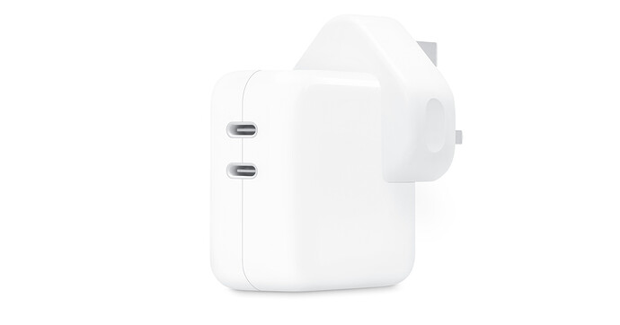

It’s been charging plugged into a Mac mini, a USB-C breakout hub and now it’s working plugged into an APPLE dual 35W charger:
This charger previously did not work with my Teracube 2e, proved to me recently when it was the only charger I had on a trip so ended up having to charge from a tiny lead I had from a USB-A port on the back of the hotel TV. Even the hire car only had USB-C sockets so was not able to charge whilst driving either!
