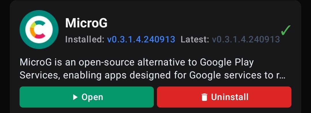

, need assistance microg apk
Welcome!
What do you need assistance with?
The official TeraCube ROMs for the One/2e/2s/Thrive do not use microG, but rather stock Android and Google Play/Mobile Services.
If you are using a TeraCube 2e/2s on Murena /e/OS, microG is handled and updated exclusively via the monthly /e/OS updates and should not be interfered with manually.
If you are using a TeraCube 2e/2s on Murena /e/OS, microG is handled and updated exclusively via the monthly /e/OS updates and should not be interfered with manually. Remove potential
