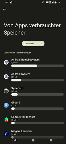

factory reset done, problem is still around. regular reboots which also lead to a basically unsuable phone due to lag for some minutes after the reboot.
When i check the ram usage after a reboot it doesnt look like ram is fully used though. Only unusual thing for me are the two android systems being shown
