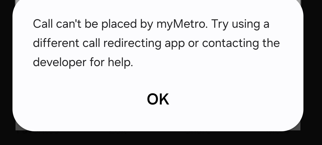

I have issues when dail phone . Kindly need assistance
